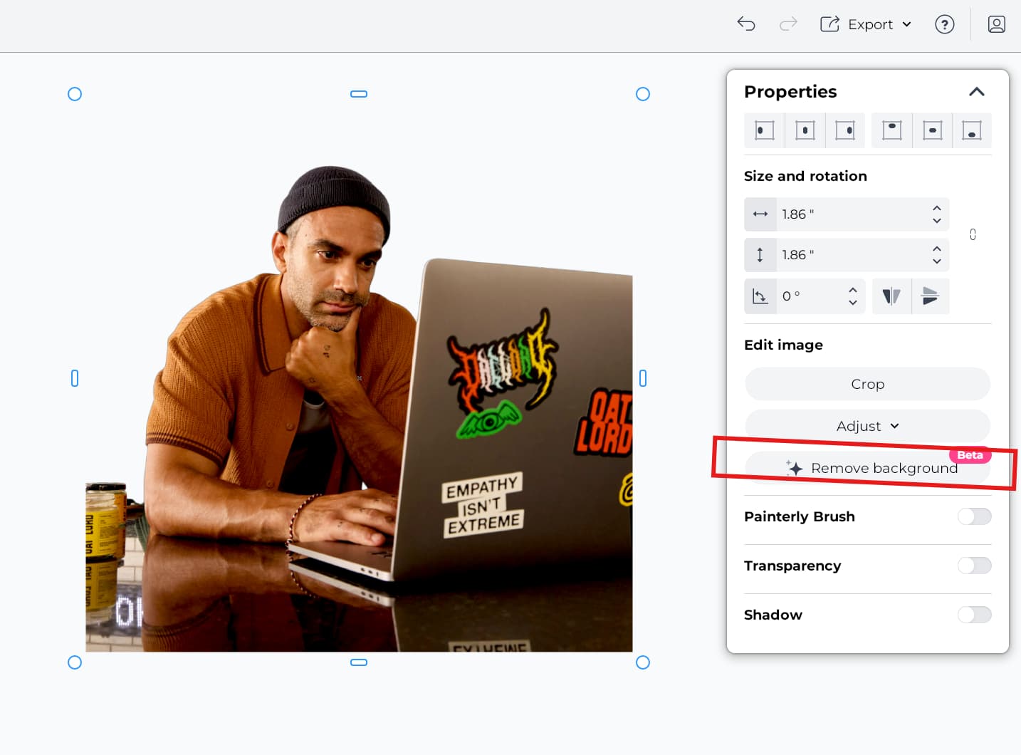

Hi @Cristian, the (beta) background removal feature has been released, and We’d love to hear what you think of it. Was it what you expected?
